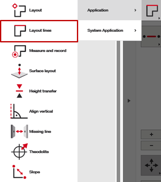

Select the Application from the Menu
When you are ready to conduct point layout, find the application from the home screen or from the side menu in CAD view of your project.

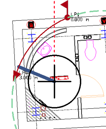

When creating an arc using 2 points and a radius, you also need to pick which section of the circle the arc should follow.
Examples:
  • “Right, big” = larger arc on the right side of the circle
  • “Left, small” = smaller arc on the left side of the circle (see screen shot below) The app will calculate the correct arc based on your choices and draw it accurately on the CAD file

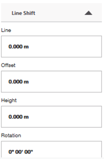

Line Shift (Optional)
Before measuring, you can choose to shift the selected line’s position or rotation. This helps if the default alignment is tricky to follow on site.

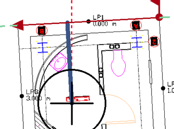

To explain this, please see the screenshots below. The first screenshot shows the line without a shift. The icon with the red flag indicates the line’s beginning point.
In the second screenshot, you can see there is a shift of the start point 1m along the line, a 1m shift of the line to the right, and finally the line rotated 45°.
If Line Shift helps your layout, it’s easy to learn by watching how the shift affects the line on screen. Just experiment with a few settings to see how it works.

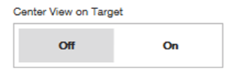

  1. Center View on Target: Keep this turned off if you intend to zoom and pan around your CAD file while working, keep this turned on if you would like to see the location of your laser or prism while working.
