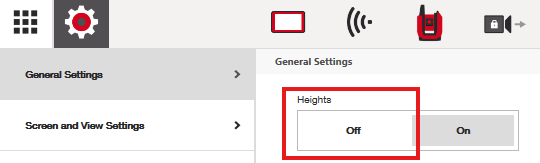

If you are not working with heights, and would prefer to turn them off, simply go to general settings and turn heights off. In this mode, your total station will only record Norther and Eastern values as you work.
