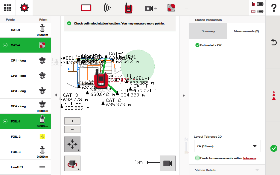

Take the below example. The software is helping me understand that my stationing set up is likely not optimal:
I have measured in 2 control points. You can see in the bottom right hand corner of the screen that my "layout tolerance" is 10mm. Using only two control points, and based on how accurate my measurements were, the software is warning me that the total station will only be able to guide me to a 10mm accuracy in the small area indicated by the circle. Anything else outside of that, and it is likely to be inaccurate.
Should I use this stationing? Likely not. I should find a better control point set up.

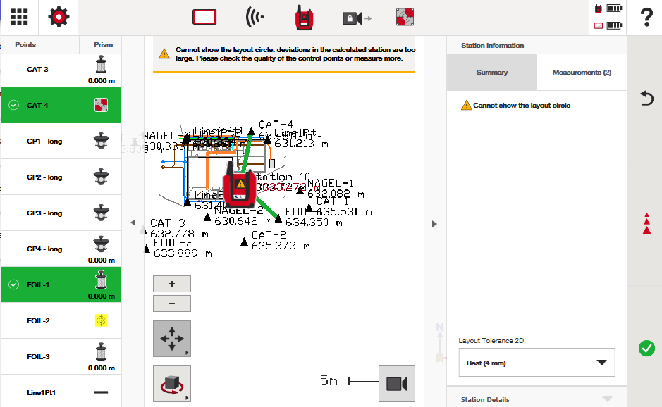

Now notice what happens when I increase my tolerance to be 4mm in accuracy:
The software will not be able to show me a layout circle - suggesting that the control point set up I have is too poor to layout to 4mm accuracy.

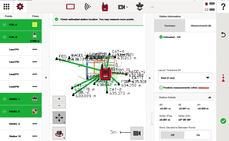

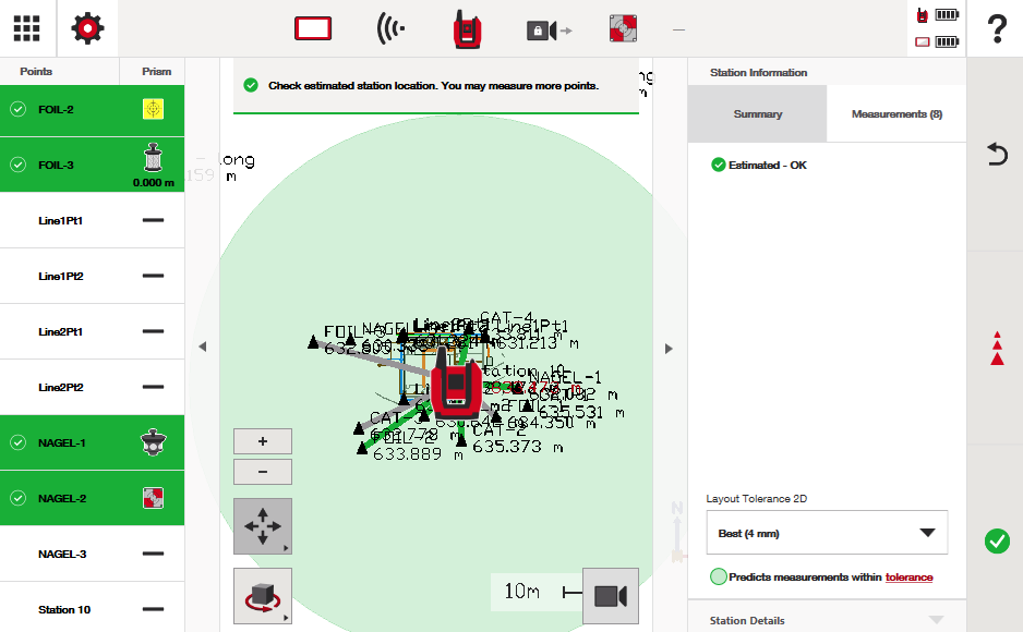

Below you see that I have now measured in 8 different control points around my jobsite, and finally, I was given a layout circle that suggests what where my 4mm accuracy requirements can be maintained.
Here is what that layout circle looks like if I want to maintain a 6mm accuracy:

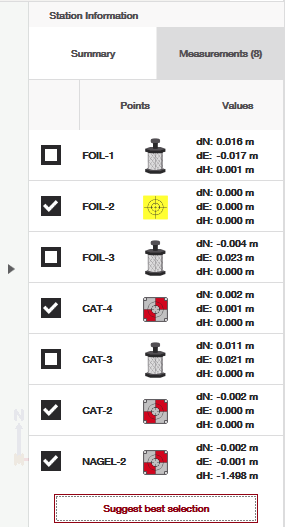

Once you measure in your control points, navigate to the "Measurements" tab in the top right corner. It will show you each control point you measured, as well as the deviation values among them. For a quick definition, those deviation values reflect how much the tool had to adjust that control point's measured location to get it to "fit" with the digital design.
By default, the software uses all the control points you measure in to calculate the layout circle you intend to work with. However, you have the ability to manually remove, or have the software automatically deduce, the control points that are likely inaccurate and hurting your potential accuracy for measuring and layout.

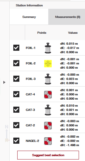

For example, let's click "Suggest best selection" from the above list to see if the software can remove some poorly measured control points in the stationing calculation:
What you see is that the software was able to find control points that would allow you to layout with the highest accuracy possible, given the control points you provided. At 4mm layout accuracy, I can confidently layout my entire jobsite area.
