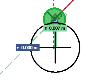

RED point being 7mm away from desired point, with a tolerance setting of 6mm.
GREEN point being 7mm away from desired point, with a tolerance setting of 8mm.
Notice that the difference or red and green colors was changed simply because of the tolerance setting chosen.

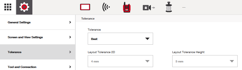

How do I change my Tolerance Setting?
Navigate to the settings tab and simply choose your desired tolerance from the drop down menu.
You will be able to see the tolerance that is set by default, or you can define your tolerance by yourself. In addition, you can indicate if you would like the green circle (recommended measuring area) to be visible during the stationing process for control point or control line stationing:
