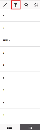

If you only want to view or edit specific points, you can use the filter option:
Notice that more than one filter can be applied, and the software conveniently shows details of where filters are being applied:
Filter by point type, point name, time created, by coordinate, by attribute. It is important to note that while it is possible to edit any type of point, when editing multiple points at once, it is required that they are the same point type.

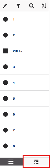

Other helpful viewing tip:
When you press the "expand all" button, you will be able to see more details regarding your points on the screen without going into the edit points menu:

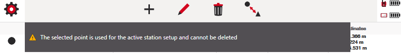

Delete selected points:
Note that certain control points will not be able to be deleted if they are used in the current stationing:
Note that if you delete a station point, the linked data to that station point will also be deleted, such as staked points, stationing report data, and points measured through "measure and record." It is recommended that you export relevant point data before deleting station points in case you need  information later.
