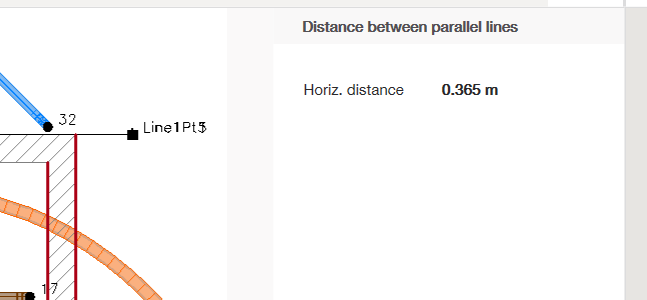

  3. Select Two Parallel Lines and Measure: Follow the prompts to get your output.
The lines you select should turn red and if they are parallel a green check point should appear on the right hand side. If not a message will appear saying "Please select two parallel lines". Next click on the green check point and your measurement information will appear on the upper right hand side.
Understanding the Output
Once you press the green check mark, you can view your output and the Horiz. Distance (Horizontal Distance) will appear, giving you the horizontal distance between the parallel lines. In the example below this is 0.3 m.
