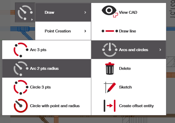

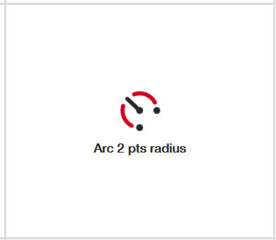

    • If you do not have the 'Arc 2 Points Radius Application' in the home screen, select add shortcut and add the application shown below.
    • To open it from the lefthand side menu, follow this path: Draw > Arcs and circles > Arc 3 pts
