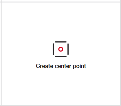

    • If you do not have the 'Create Center Point Application' in the home screen, you can select add shortcut and add the application shown below, or navigate to it from the navigation menu.

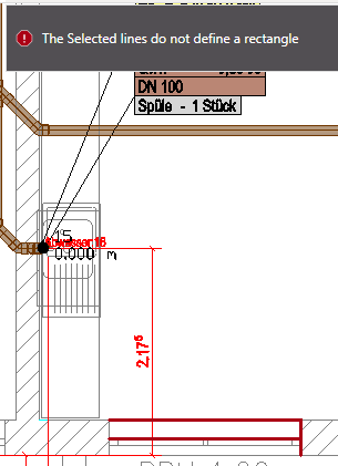

If you get the message "The selected lines do not define a rectangle" make sure you select three lines of a rectangle instead - the lines you are using must be able form a rectangle or square.
In addition, this application works only when selecting objects that are categorized as "lines" within CAD. If you are attempting to find a center point of an object that is not defined as "lines" in CAD (a 3D object or a decorative object, for instance), this application will not work.
For instance, I am not able to select this 2D piping image, even though it looks like it forms a square, as the object's boundaries are not technically defined as "lines."
