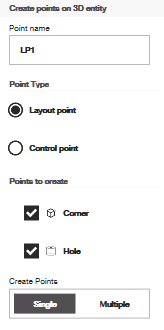

On the right hand side of your screen is a menu where you can select the type of point you are making (layout point or control point), as well as the 3D entity location where you would like the point to be created. Use this menu to also name the point(s) you are creating.
The option to create "single" or "multiple" points is simply asking if you would prefer to place your points individually on your 3D object (click by click), or, if you would like to create points at every applicable location automatically when you select your preferred 3D.
