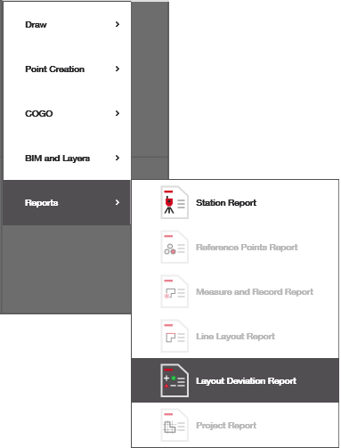

Step 1: Navigate to the Reports Tab
Find the Deviation Report export available under the reports section:

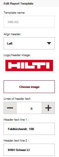

Step 2: Assign your Preferred Template
You have the ability to edit the template and export type of your deviation report

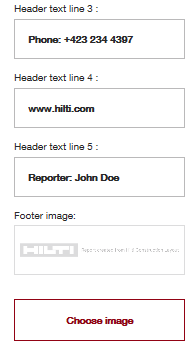

Step 3: Edit your Template (if needed)
You have the ability to press the "edit template" button to edit information found in the header and footer of your deviation report:

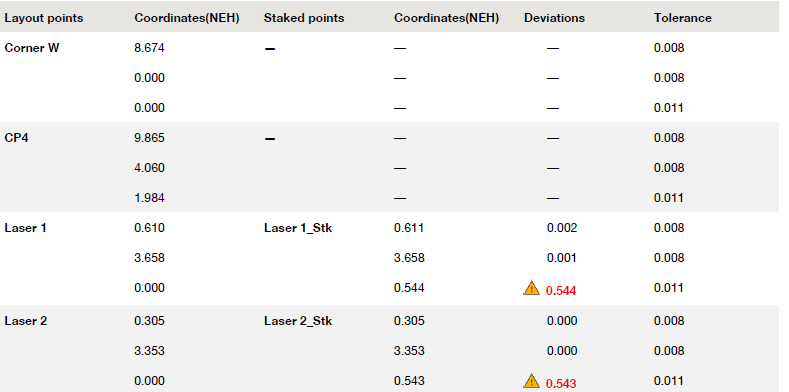

How to Understand the Data in a Deviation Report
The data is organized to quickly see errors:
  • Points that are staked are labeled with a "_Stk" in their suffix
  • Both the layout point and the staked point's coordinates are easy to find and compare
  • Red text with yellow triangles appear for any point that is staked outside of your designed tolerance
    • Please see this article to understand what tolerance is and how to set it.
  • When exporting this as an excel file, you can adjust and format the data as you please.
In the below screenshot example, the tolerance was 8mm on layout, and 11mm on height. The software identified the errors where my points were staked out of tolerance compared to the design:
