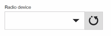

Under the "Radio Device" setting, make sure to find your Radio Bridge which you have just paired to your tablet.

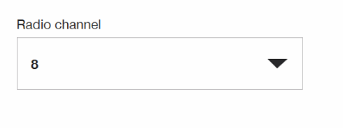

Lastly, make sure the radio channel you indicate on the tablet is the same as what you indicate on your POS head unit.
