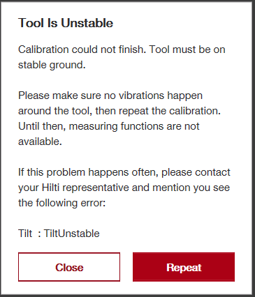

"Tool is Unstable" Error Message Guidance
This article will discuss what may cause the "Tool is Unstable" error (see image below), and how to potentially resolve it. This error may also appear as "Vibration Detected."
The Tool Is Unstable message can be raised during both tilt and field calibration. While the internal detection logic differs, both cases indicate that the instrument could not complete calibration due to physical instability or motion during the calibration process. Because the corrective action is the same (stabilizing the setup and repeating calibration), the resolution message is identical.
Sub-error codes associated with this might read "Tilt: Tilt Unstable," "Tilt 408: Instrument Unstable,"  or "Field: Instrument Unstable."
