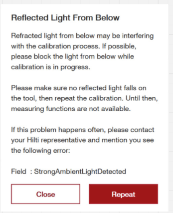

Why this Error Occurs
During field calibration, the instrument must observe internal reference signals using its optical system. These measurements depend on clean, controlled light paths.
The “Reflected Light From Below” error appears when unwanted light enters the optical path from below the instrument, interfering with those measurements.
In simple terms:
The instrument is seeing light it did not expect, coming from the wrong direction.
When this happens, the calibration measurements become unreliable, and the instrument stops the process to protect accuracy.

Best Methods to Resolve: Reduce Reflected Light
Change the setup location
If possible, move the instrument slightly to a location where the surface below is:
- Darker
- Less reflective
- Matte rather than glossy
Even moving a meter or two can significantly reduce reflected light.
Shade the area beneath the instrument
If relocation is not possible:
- Place a non‑reflective material (cardboard, fabric, matte cover) on the ground below the tool
- Block direct sunlight from hitting the floor beneath the instrument
This often resolves the issue immediately.
Adjust timing if working outdoors
If the sun is low in the sky:
- Wait until the sun angle changes
- Avoid calibration during early morning or late afternoon if glare is present
Turn off or reposition work lights
Ensure that no lights are shining upward toward the instrument during calibration.
Repeat the calibration
Once reflected light is reduced or eliminated, repeat the field calibration. In most cases, calibration will complete successfully once optical conditions are clean.
