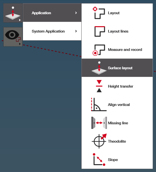

  2. Open Application: Open the Surface Layout application either from the home screen or from the side menu in the CAD view.
    • If the application is not available on the home screen, select Add Shortcut and add the Surface Layout application.

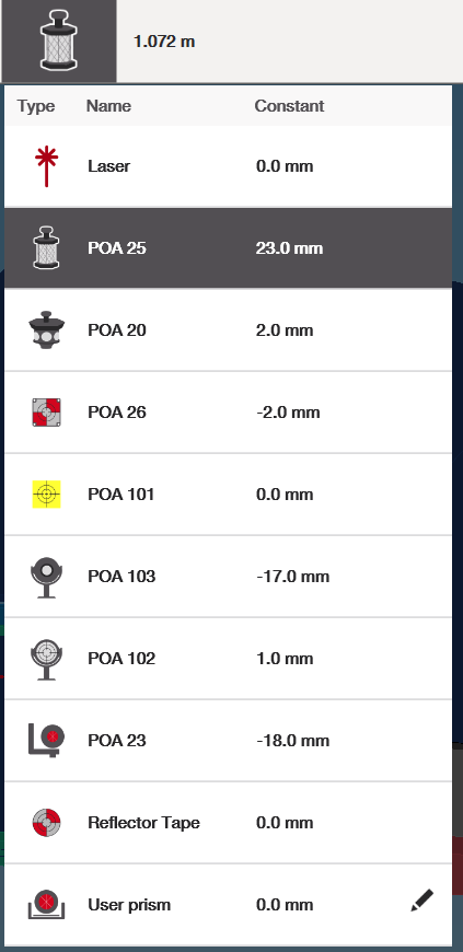

  3. Select the Prism: Select the prism that will be used for measurement. The prism height must also be entered by selecting the height value next to the prism selection and adjusting it accordingly.

Selecting the Surface Layout application from the side menu in CAD view:
Selecting the prism and setting the height:

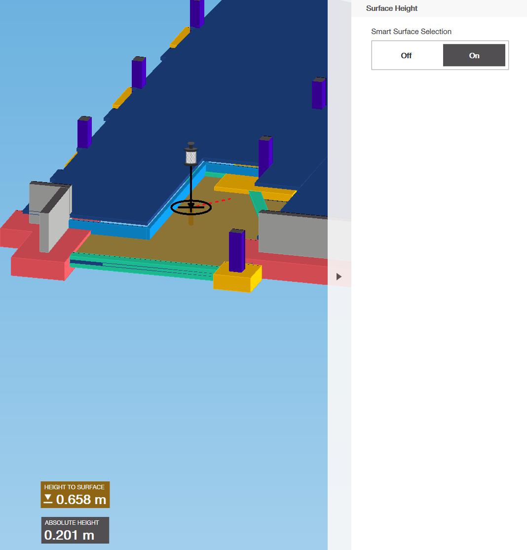

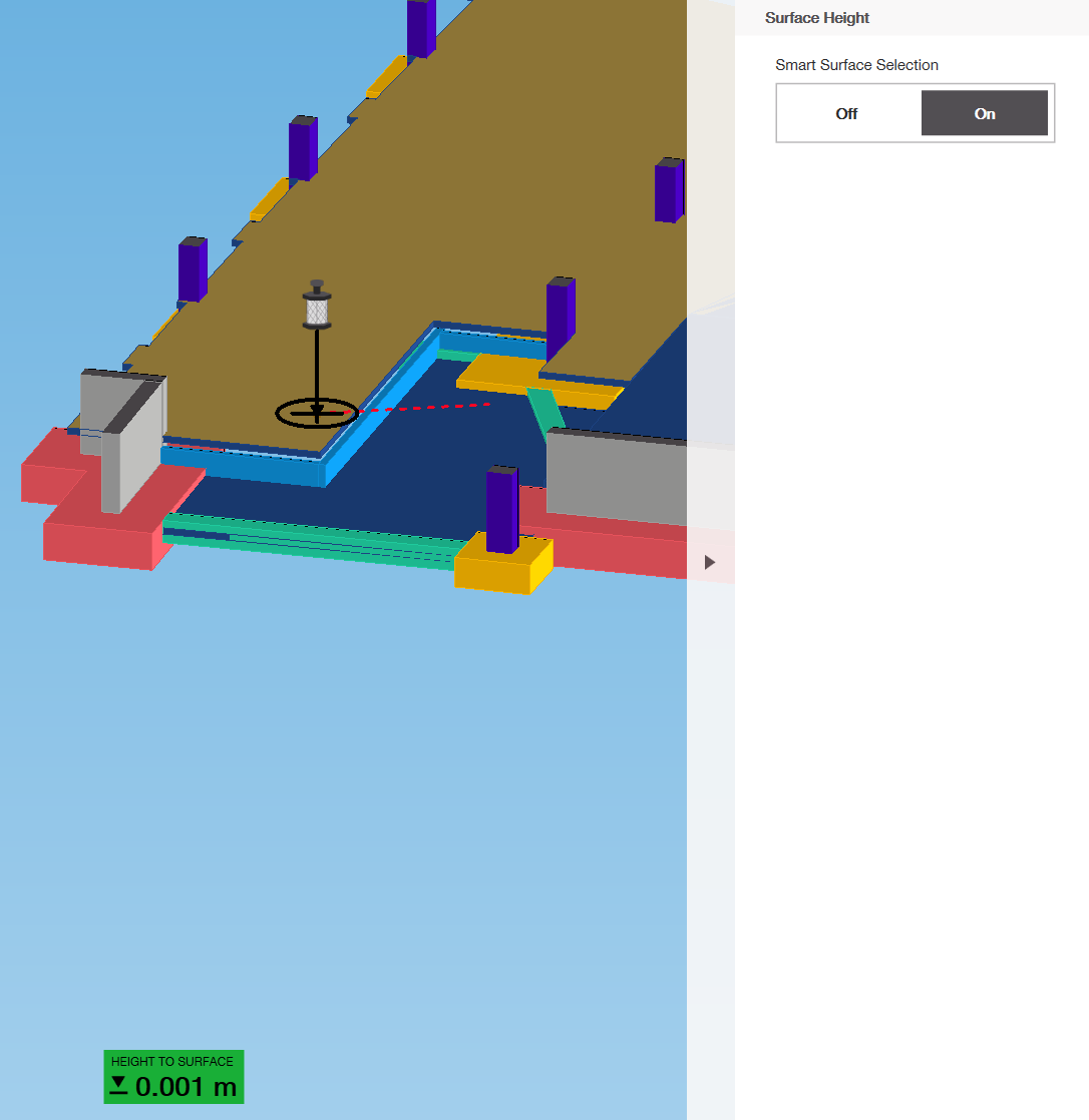

Smart Surface Selection: HCL recognizes when your location has moved from 1 3D surface to another, automatically:
How to Use Smart Surface Selection Function
The Smart Surface Selection option is available on the right side of the screen.
When enabled, the application automatically selects and highlights the surface used as the height reference directly in the CAD view.
When disabled, the reference surface must be manually selected by tapping the desired surface in the 3D drawing.
It is recommended to keep Smart Surface Selection enabled, as it simplifies operation and reduces the risk of selecting an incorrect surface.
Smart Surface Selection option:
