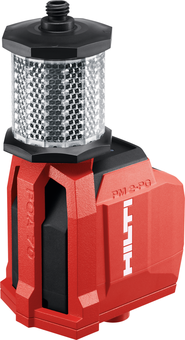

The POA 70, or Hilti's "Layout Point Laser," allows layout crews to achieve high accuracy while dramatically simplifying their workflow - especially in complex and imperfect jobsite conditions. With the POA 70, you can transfer layout points directly to the ground or ceiling using a visible laser point.

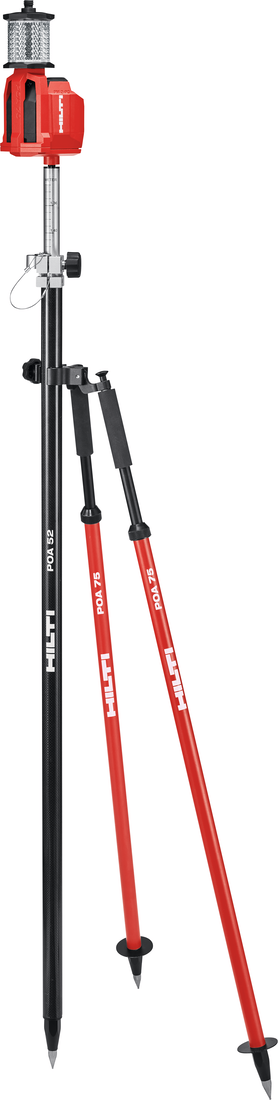

Note: The POA 70 is a bracket + PM 2-PG combination that allows a plumb laser to sit on a prism rod with a prism connected directly above it.
By combining a plumb laser with prism alignment, the POA 70 simplifies traditional layout workflows and significantly improves productivity - especially in real jobsite conditions.
No complex setup required: The POA 70 layout point laser is a standard Hilti 2-point plumb laser which is ready to fasten to the top of your prism rod. Once fastened, screw on your prism and you are ready to work. No software or hardware changes need to be adjusted; it's a "plug and play" solution.

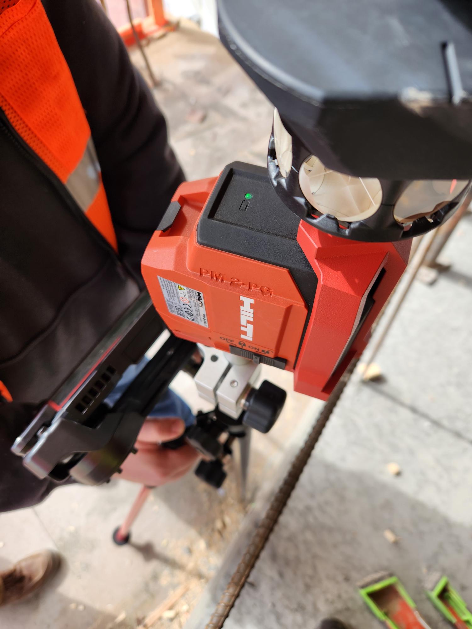

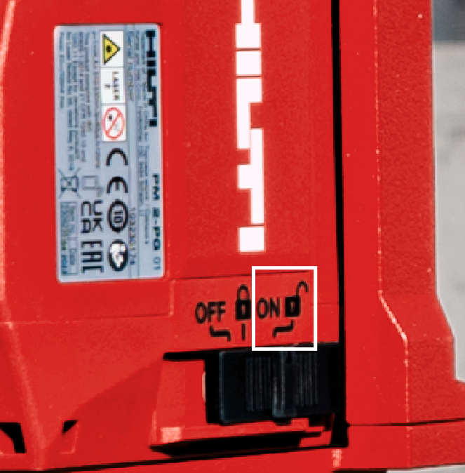

Important User Information - Keep POA 70 in "Unlocked" Position
The pendulum for the laser needs to be in a free unlocked position for it to give you the true plumb point beneath your prism. If the POA 70 is "locked", it will not be vertically plumb.

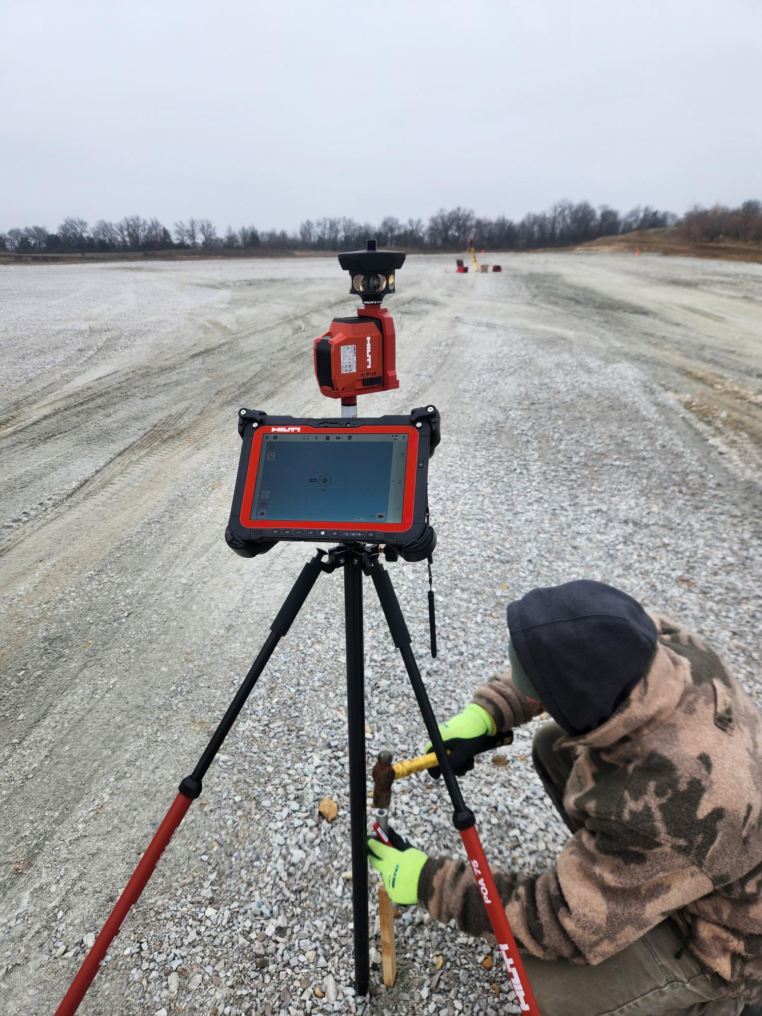

  • Gravel, dirt, or grass can make identifying your point with a prism pole difficult
  • Stabilizing the POA 70 to then identify the exact laser location ensures accuracy and speed of layout
With POA 70: locate the laser within a small area near the pole and easily clear debris (even by using your foot) to find the point.
Stake Installation and Adjustment
  • While hammering a stake (for point or height references), users can:
    • Adjust position after each strike
    • Keep the laser aligned to the stake center
With POA 70: Enables real-time corrections during installation without awkwardly holding a prism rod to the top of a narrow stake.

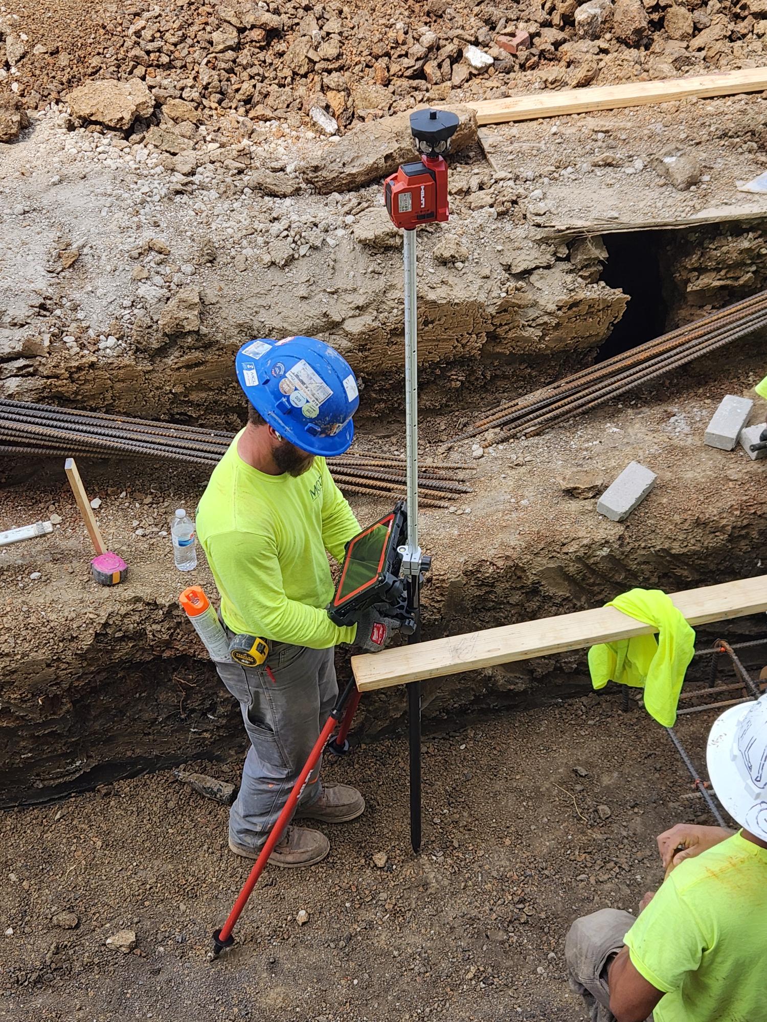

Obstructed Areas (Rebar, Tight Spaces)
  • Rebar congestion or obstacles can block pole placement
With POA 70: Prism pole can be stabilized near the required point, while the POA 70 gets adjusted to identify a point's location within the congested area.

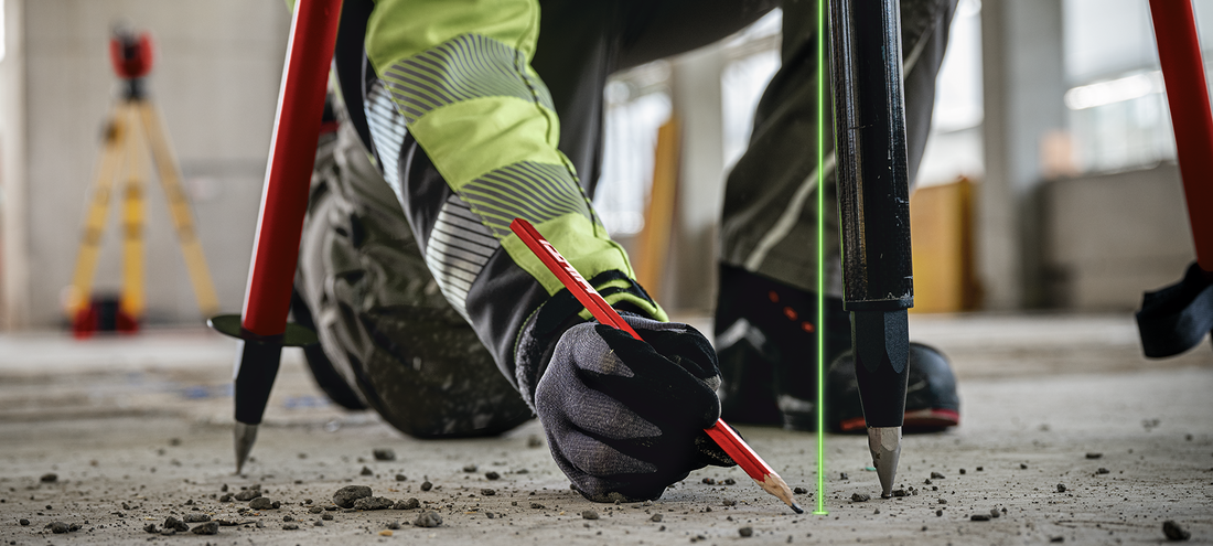

Retaining Point Visibility
  • Traditional workflow loses the point when the pole is removed
With POA 70: Easily maintain a visible reference point during transitions from prism pole placement to point marking.

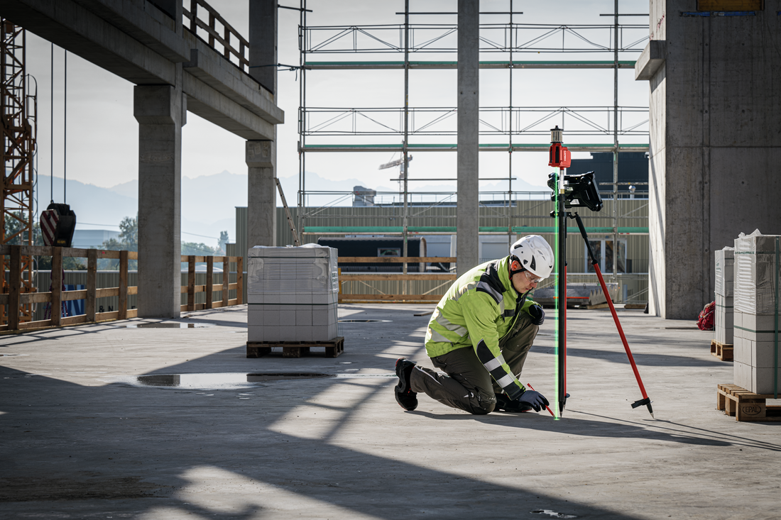

Visualizing Ground and Ceiling Points Together
Thanks to the hole centered through the bottom and top of the POA 25 , users can mark a layout point on the floor while easily referencing its vertical alignment. This allows them to quickly look up and visualize where the point will project on the ceiling, or identify potential conflicts such as ductwork, sprinkler pipes, or other obstructions.
