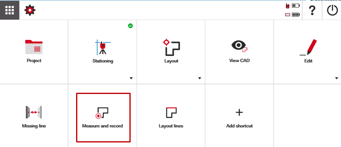

Measure and Record - How to Use
Measure and Record Demo
The Purpose of Measure and Record
To use “Measure and Record,” you first need to be stationed (i.e. the tool needs to know the coordinates it is located at on your jobsite). Please make sure you station your tool before attempting to use “Measure and Record.”
This application is designed to measure exact locations of points as they exist on the jobsite. Common applications for Measure and Record are to perform quality checks of objects already installed, or, to record new control points that have just been secured throughout the jobsite.

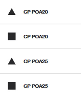

How Measured Points Appear in your Point Menu
After a point is measured, it will appear as a square icon in your point list, as well as on your CAD view. If you measured the point in as a control point, it will also appear as a triangle.
