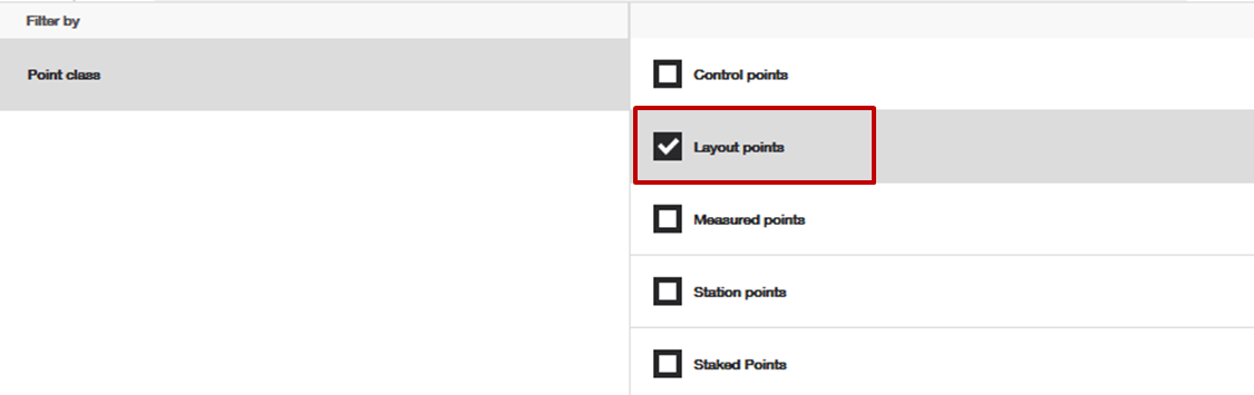

While not necessary, it can be be common to work with pre-loaded layout points. If this is your case, it’s often beneficial to make sure only “layout points” are showing on the left side point menu. If this could benefit you, filter your point list by pressing the filter icon in the left-hand point menu, and selecting only “layout points” to be shown.

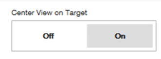

It is also helpful to know how to optimize your working window when doing point layout. From the right side menu, you will see the option to “Center View on Target.” In general, it is best to have this turned off if you are panning your CAD file to find a point to layout, and best to have this turned on when you are following the prism or laser to your point.
All this option does is centers the view window on your prism or laser’s current location, or, it allows you to freely pan your CAD file.

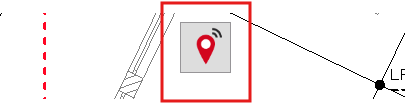

When this option is turned off, a location icon will appear at the top  of your screen, which you can press to automatically return to the location where the tool is locked to a prism.

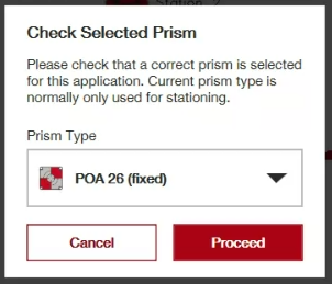

If a target was previously selected, HCL will prompt you to switch to a prism when entering Layout mode, as prisms are required for laying out points. Confirm the prompt to change the target type before proceeding with the layout operation.

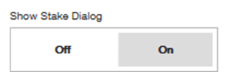

Notice that at the bottom of the right side menu, you have the option to “show stake dialog.” By default, this is turned on for you to add any additional data to the point you just laid out – adding attribute notes, defining the layer you would like the point to be on, or even re-naming the staked point.
You can turn off this menu if it is not relevant to your workflow.
