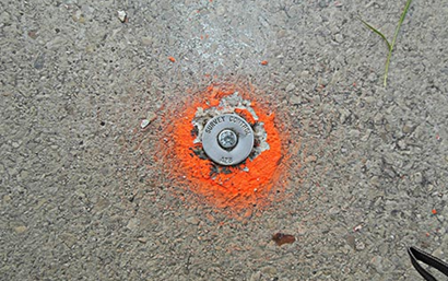

  4. Give priority to control points that are secure and immovable

When in doubt of which control points are accurate or inaccurate, it is prudent to prioritize control points that seem to be secure and immovable, such as control points that are mounted or anchored in place. If these are measuring inaccurately, it is more likely that they are drawn incorrectly on the CAD or labeled incorrectly within your project. If these types of control points do not help station the tool, speaking with the general contractor or surveyor may be required.

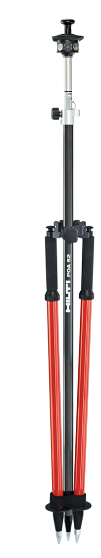

Keep prism low to the ground during stationing if possible:
If you are using a prism rod to station the tool, such as the image below, consider putting the prism on the bottom of the pole, rather than the top. Having the prism on the bottom of the pole reduces the possible error of the rod not being level when the control points are being measured.
Whether the prism is on the top or bottom of the prism rod, be mindful of keeping the prism rod level, especially when using it for stationing.

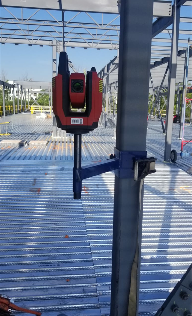

Secure the total station from slipping and vibrations:
Use creative measures to secure the head unit from vibrating or slipping. While the tool does run its own calibrations, making sure it is in a secure and stable location on the jobsite gives you the best chance of maintaining accuracy throughout the layout experience.

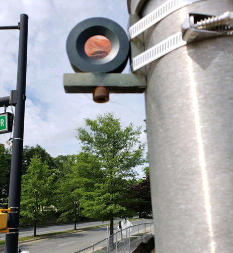

Add back-sight prisms as additional control points:
After the tool has been stationed, it is always wise to use the Measure and Record application to measure in additional control points that can be used in the future. Using back-sight prisms, such as the POA 103, are a great way to secure consistent jobsite control. The more back-sight prisms you save as control points, the more likely you are to mitigate the consequences of having control points get hidden or removed during the project.
