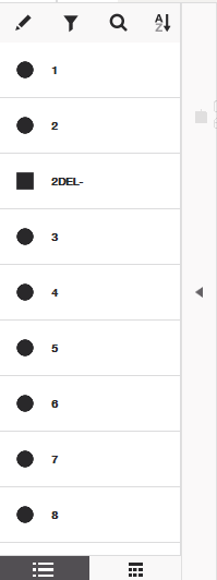

An easy way to check if you have control points in your data that are ready to be stationed with, go to CAD view on your tablet:
Then, open your point list from the side menu:

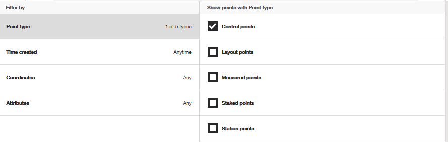

Then, filter just for control points by pressing the filter icon at the top of the points list and pressing the green check mark:
Lastly, see what remains in your point list and verify that the information is correct. Control Points will show up as triangles in your data set. They will be points at specific coordinates in your data, and the software may even have a specific prism type associated with them, depending on how the control points were established in the data.

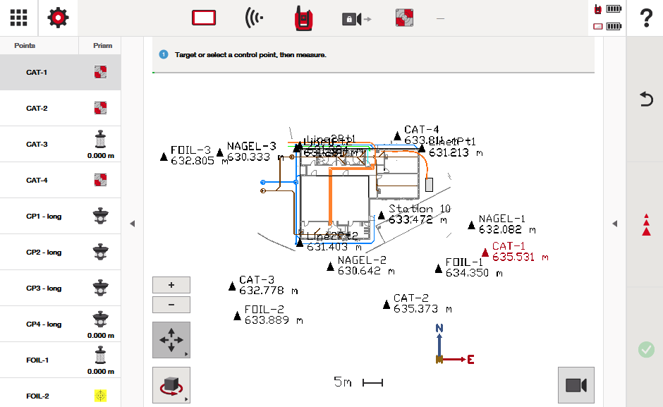

To select a control point, you can either select it from the side point list, or simply tap the control point right from within the CAD view:

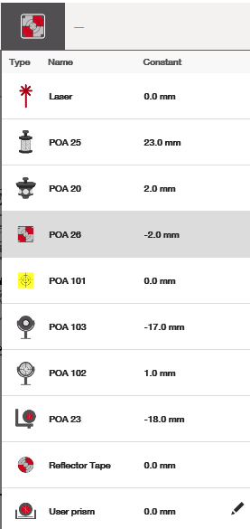

If the target at the top of the screen is incorrect, for whatever reason, change it to the target type that is associated with the control point you are measuring:
If you believe you may have measured the incorrect point, don't worry. You can always go back and remeasure any control point during this process before you accept a stationing. Simply select that control point again and re-measure it.

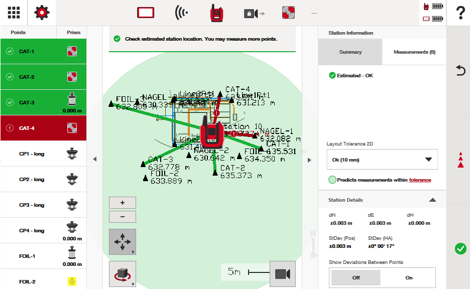

After measuring each control point, you will notice that they will turn either green or red, depending on your tolerance settings. Please see this article to understand what the tolerance setting is. You can always adjust your tolerance setting from the right window.
If you see red points, you know that the point was measured with an error greater than your tolerance setting. If it is green, it was measured with an error that is within your tolerance settings. These are visual cues to help you know where issues might be.
You will also see a green tolerance circle. This, also, is based on your tolerance setting. The green circle will indicate the layout area in which you can be confident to layout to the level of accuracy your layout tolerance is set to. See this article for more information on how this green circle can be useful to you.

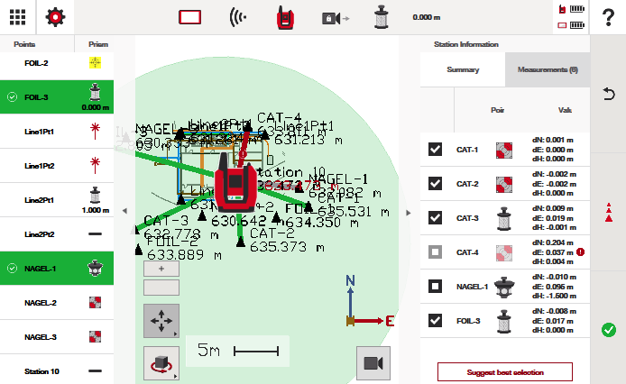

Find the best recommended control points from the measurements tab
By opening the measurements tab, you will see the control point data that you have measured, as in the example below:

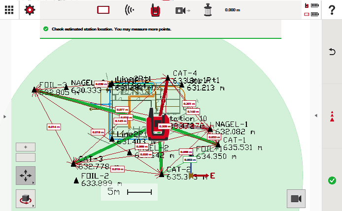

The deviation value information shows you how much the software had to adjust the point from its measured location to make it fit the design the digital file was looking for. Notice that for the point "CAT-4," it was  impossible to use in the stationing calculation. This point, in relation to the other points measured, was impossible to realistically fit to the way the design called for. This point was too far off its designed measurement (200 mm at least) to even be considered.
Notice that you can manually select the control points you would like to use as part of your stationing calculation, or, you can click "Suggest best selection" to have the software find the optimal points to use that seem to be  the most accurate.
Notice that when we clicked "suggest best selection," the software found the control points that could be used with the least amount of adjustments required. It removed "NAGEL-1" from the calculation, giving the widest layout circle possible according to your tolerance.
Again, you can click on the points you prefer to use in your calculation manually; the end user always has control when it comes to layout.
Observe the deviations between points
On the bottom right of the screen, under "Station Details," you will see the option to turn on "deviations between points."
This is extremely convenient to inspect whether or not  control points you have measured are accurate to the design.
Notice that the software will show how far off the points are between themselves based on the expected horizontal distance the design calls for, saving you time from going back to check these deviations some other way yourself.
Press the green checkmark when you are satisfied with your results
Simply press the green check mark in the bottom right of the screen when you are satisfied with your stationing results. Your head unit will now be given a specific coordinate, representing where it is located on the jobsite. It will know its location and its orientation, ready to guide you in your applications.

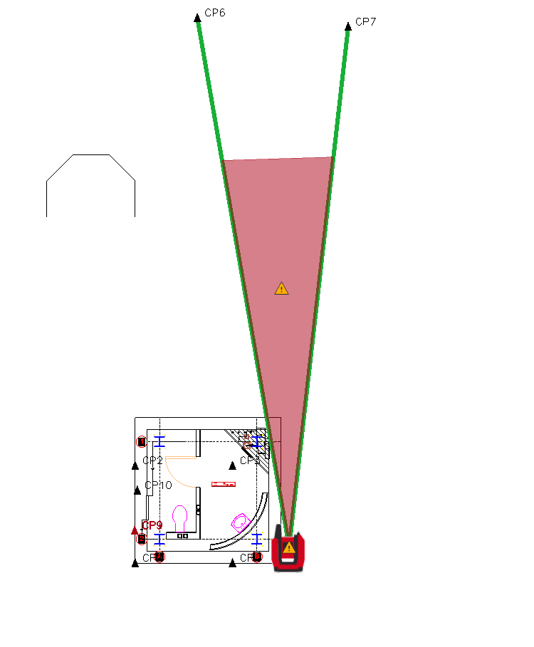

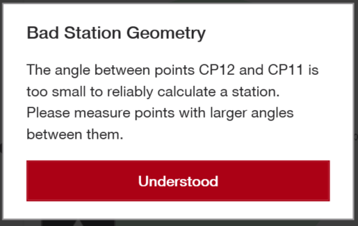

1. If the angle between the measured control points is too small, HCL will display a warning message and recommend measuring points with a larger angle between them. This warning is also indicated in the CAD view, where the measured angle is highlighted in red.

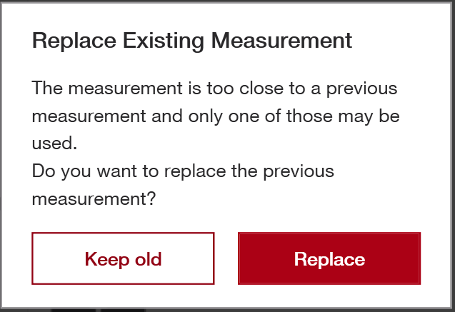

2. If two measured points are located very close to each other, or even at the same position, HCL will prompt you to either replace the existing measurement or keep it. Since the measurements are essentially identical, one of these options must be selected before continuing; the prompt cannot be ignored.
