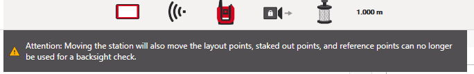

You will be warned, upon opening, that the software will treat this as a brand new stationing location. If you were to go back and check previously staked or laid out points with this new stationing, the new station would guide you to the new position of these as well, according to how the station shifted.

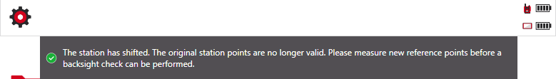

How-To Step 3: Accept the Stationing
Press the green check mark, and the tool will automatically remind you that the station shifting is completed. If you need new points to reference as backsights during your work, simply use measure and record to re-measure some points of reference you can check throughout your work day.
