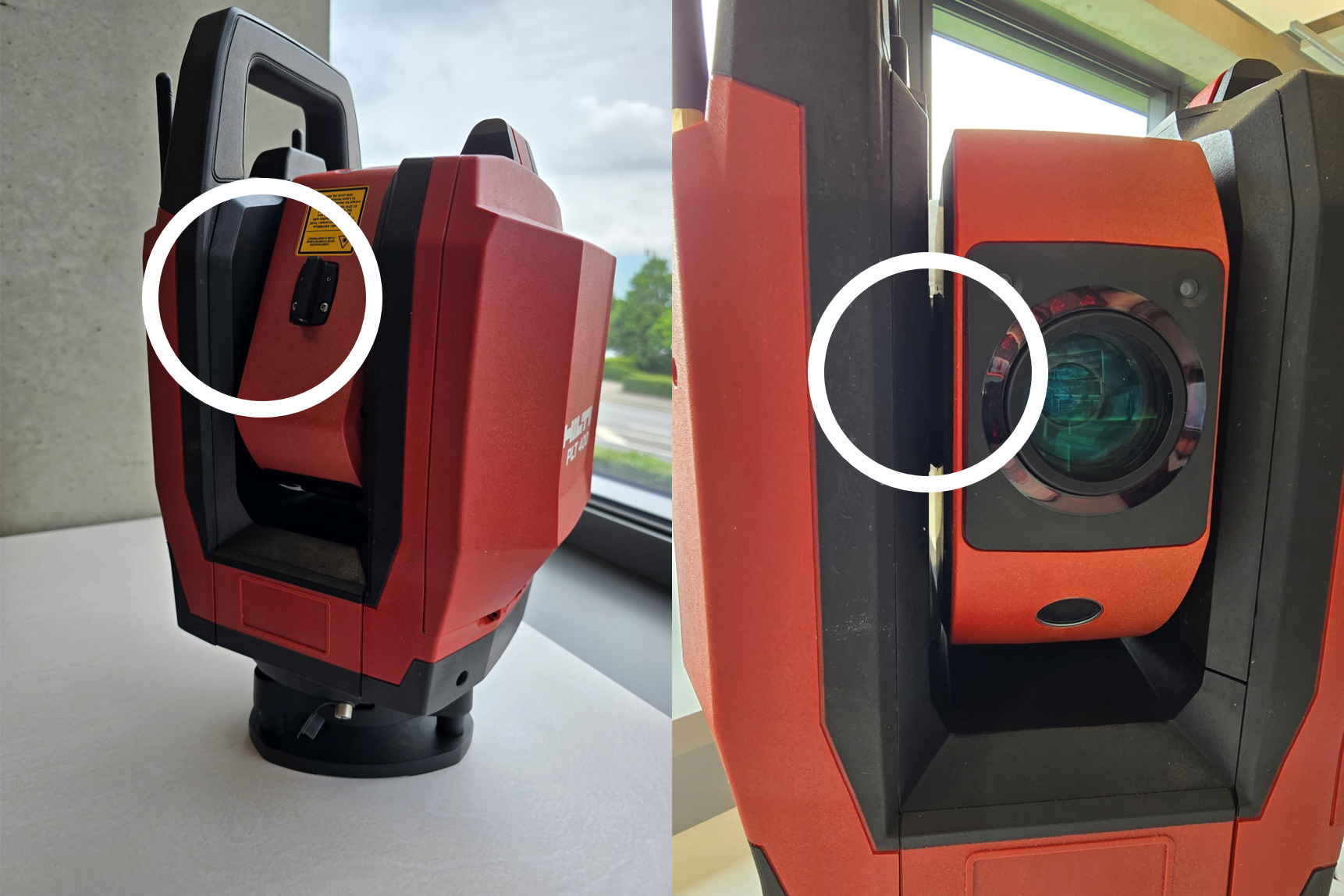

1. Inspect the Mirrors and Lens - Dry with Cloth
Please inspect the lens (1), the collimator (2), and the two calibration mirrors (3). These locations run your calibrations and measurements as the tool is being used, and if anything (usually water or dust) is inhibiting them, it could lead to calibration and measurement failures.
